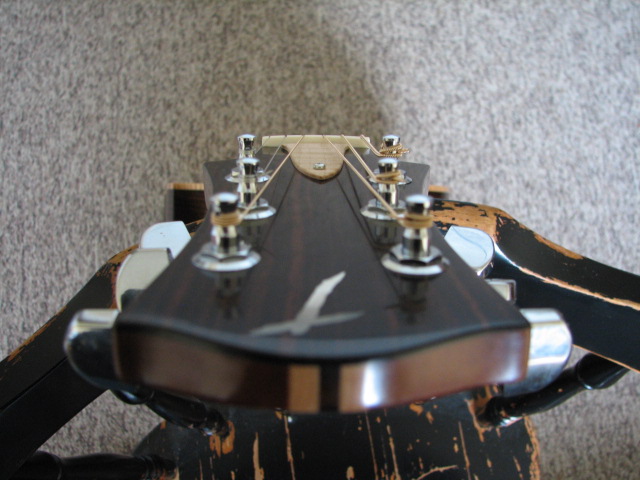

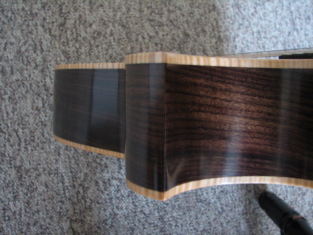

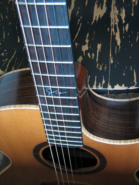

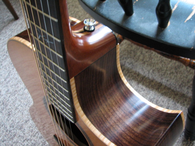

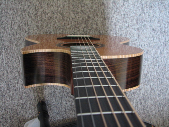

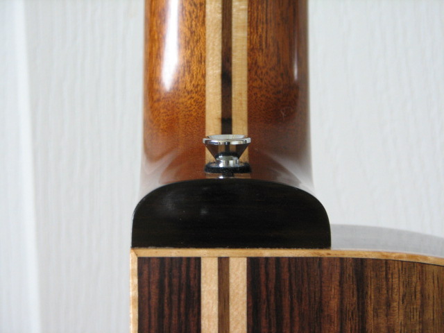

Alain, I've used the mowhawk classic instrument lacquer.
I love it, if flows out nice, sets up well and rubs out great. What more can I say.
The last guitar I did was with it, and although it was a satin finish, you be the judge..............(don't you hear the "on hold" music?)
(pictures to come later tonight)

Ya Tony, steel wool and paste wax. Maybe it's more of a semi-gloss now that I look at the pics again.
Here are some pics Alain
PostPosted: Wed Nov 15, 2006 5:22 pm
Wow, Rod...that's beautiful!

Ah Rod... I never tire of seeing that gorgeous guitar man!!! I love the way the neck lamination crosses over to the back strip... or is that the other way around? ... I really like the cutaway joint too! Well done sir!
